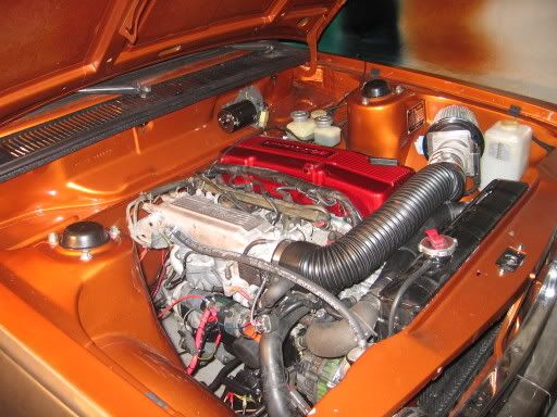

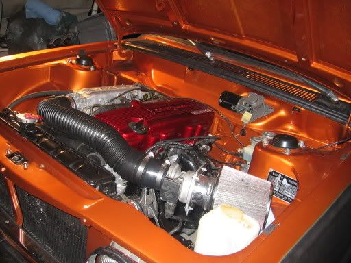

finally got pics of the new motor in the 510
look at that sr20 red top haha yeah rite

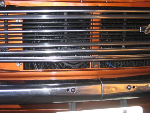

the electric fan
finished :)

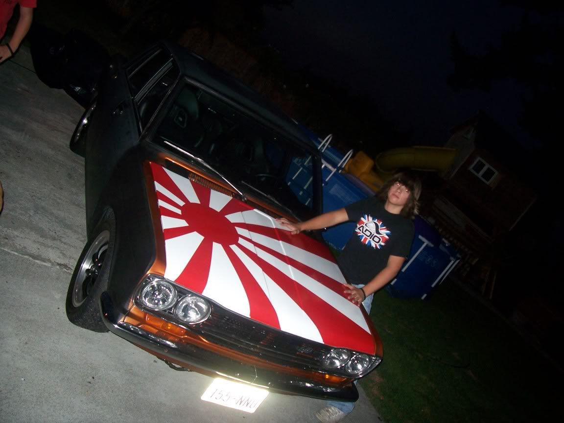

right now im painting a rising sun hood, picks will be coming hopefully tonite

Sweet job. That's what I'm fixing to do. Is that a KA24DE? What's it out of?

That things only got a single row chain!? That's insane! I've never seen anything like that... Even the L engines have a double row...

That is a single cam KA = KA24E

Racn I think it is weird about the single row chain, I think the weirder part is its always a rod knock when they are blown.. I have herd of chain failure but never seen it.
I'm thinking of doing that to my PL411. Should help hide the hole in the hood.
Looks sweet! What color is that?

That single row timing chain is one of the reasons the KA24E is somwhat troublesome. The early ones would lose the guides and that single-row chain would flop around, tearing up the timing cover. With proper METAL guide (not the plastic OE crap ones from '89-92ish) they're just fine.

look at the hood my son did.
